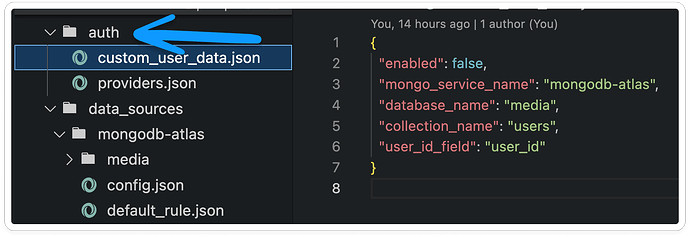

Hi @Alexandar_Dimcevski @Shahil_Shah @Paul_Vu @Erlend_Blomseth
I was able to reproduce the issue which appears to be a bug and have found a workaround.

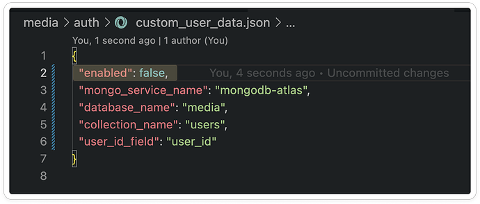

It seems to be an issue for realm-cli and github auto-deploy if the custom_user_data.json config has the property of "enabled": true
Please try these steps:
enabled property to false
If the config for the enabled property is set to false, the file will be ignored from the change and whatever is causing the bug will be overridden. At the same time it does not affect the actual cloud state of that feature and user data will remain enabled.
I’ll report this bug internally.
Regards
Manny

Hey Daniele, did you change your custom_user_data.json ?
"enabled": true, ❌
...other fields
"enabled": false, ✅
...other fields
I cannot find that file.
I got the same issue for an production app now. I didnt change anything. Using GitHub actions to deploy new schemas. I am using custom user data.
Is there a temporary workaround?
@Paul_Vu This file is in my auth folder
