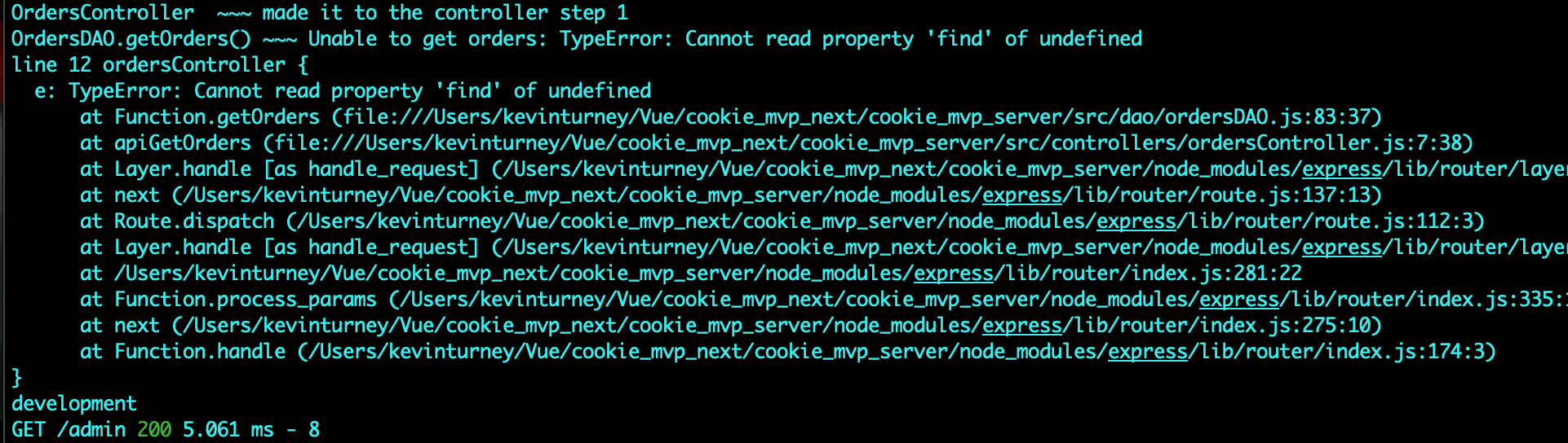

The route is hit, the controller calls getOrders() in OrdersDAO, OrdersDAO.getOrders() fails to read orders.
The following in the screenshot:
line 12 ordersController { TypeError: Cannot read property ‘db’ of undefined…
Where is this property db in the function getOrders?

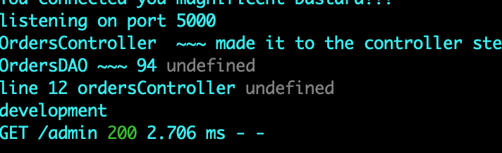

it’s not in there. When I just console.log(orders) in getOrders(), orders is undefined, still not readable from when injectDB() initialized orders.

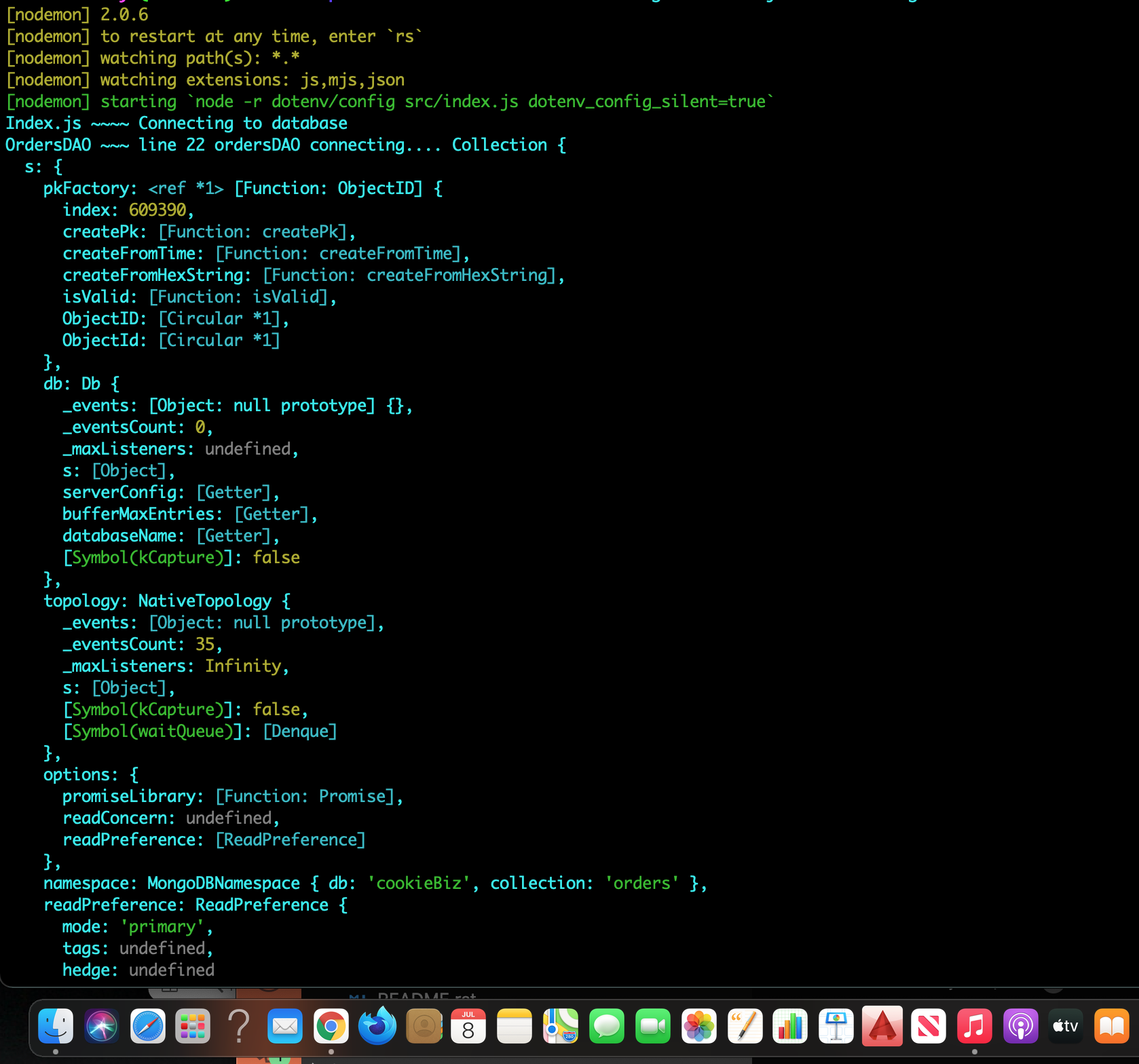

Here is the entire file for OrdersDAO
let orders
export default class OrdersDAO {

      orders = await clientConnection
        .db(process.env.COLLECTION_DB)
        .collection('orders')
      console.log('OrdersDAO ~~~ line 22 ordersDAO connecting....', orders)

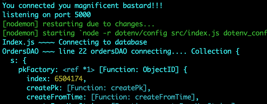

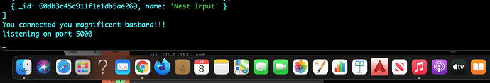

Thanks. When you start the application are you seeing these messages? If so, please include a screenshot.
OrdersDAO ~~~ line 22 ordersDAO connecting…
OrdersDAO ~~~ line 36
You connected you magnificent bastard!!!
From the screenshot I see the orders is not undefined. It has a value. And, are you seeing the above message?

Orders is not undefined in injectDB, in getOrders() it is. Look closely at the console.log statements.
@Kevin_Turney, can you post the entire error message from the post no. 24 (it is only a partial screenshot)?
