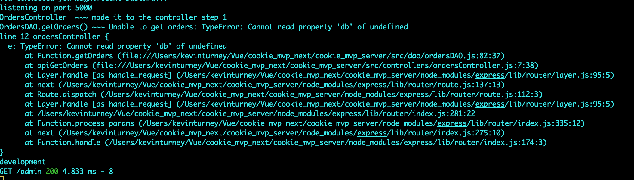

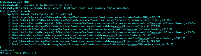

Yes this is how they use it in this application, however using this EXACT same patten, I am not getting to work.
Using injectDB(client) saves creating another module to eventually do the same thing.
The connection object passed to the OrdersDAO class, is assigned to orders, YES I know that, but if you try this, and call getOrders(), orders will still be undefined.
OrdersDAO.getOrders() ~~~ Unable to get orders: TypeError: Cannot read property 'db' of undefined
My theory is this has to be due to the asynchronous nature of the the call and how the variable “orders” is being read before initialization. Feel free to try a solution, because I have been trying hard and I’m becoming skeptical of this injectDB() pattern.
I checked the versions in package.json, checked babel plugins and presets, checked the tests folder to see if I missed something, I retyped both files just in case, I even sent a linkedin message to the author in the mflix commits. I’m stuck.
In the OrdersDAO the let orders declaration - the orders is the collection instance. This collection instance is obtained from the client connection in the injectDB() method:
orders = await clientConnection.db('cookieBiz').collection('orders');

Prasad, I have tried that, please see earlier in the post, how do you think I got undefined
static async getOrders() {
    let cursor
    try {
      // await client.connect()
      const database = await orders.db('cookieBiz') // TypeError - cannot read db of undefined
      const collection = database.collection('orders')
      console.log(`OrdersDAO ~~~ 94`, db)
      let cursor = await orders.find({})
      let allOrders = cursor.toArray()
      console.log(
        'OrdersDAO.getOrders ~~~ made it to the OrdersDAO step 2',
        allOrders)
    } catch (e) {
      console.error(`OrdersDAO.getOrders() ~~~ Unable to get orders: ${e}`)
      return { e }
from the console…
The above two lines of code are not required. The orders variable already has a collection’s reference obtained in the injectDB (think orders is the collection on which you run the query; it is this Collection class type).
Just tried your line
cursor = await orders.find().limit(10);
orders is still undefined. I don’t know, dude : ( ??!!
orders is read perfectly in injectDB(), just not getting the collection reference to getOrders().
Before you use this getOrders method you have already executed the index.js (in which OrdersDao.injectDB is run, and you should have the orders variable have a value). That is the value used within the getOrders method.
Can you tell me how and where are you calling the getOrders method?
