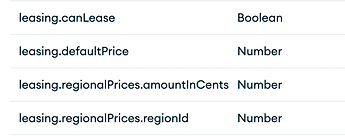

Also, here is the starting index I’m working with as it relates to the leasing field:

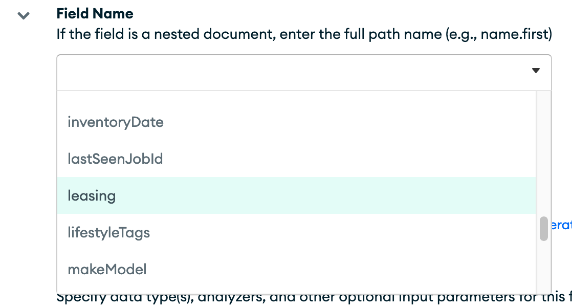

Issue 1: Can’t select the field containing embedded documents
When setting up the leasing.regionalPrices in my index with the embeddedDocuments type, I found that the dropdown doesn’t list that field:
I can at least work around this by using the JSON editor to set the field type to embeddedDocuments, but why doesn’t the field even show up in the visual editor?

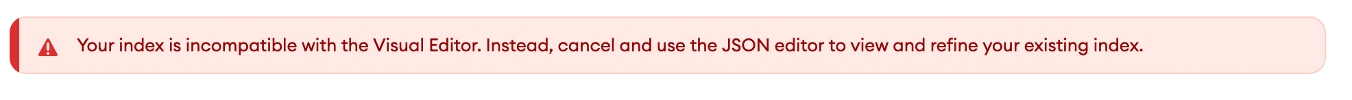

Issue 2: Can’t use the Visual Editor after setting a field as embeddedDocuments
After successfully setting my field as embeddedDocuments using the JSON editor, upon loading the Visual Editor to check things out I get the following error message:

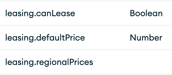

Issue 3: Sub-fields of embeddedDocuments become unavailable
After setting up the embeddedDocuments type, the fields within those documents which I previously had indexed (see the screenshot way up at the top) are apparently no longer present in the index, and the newly changed field doesn’t show any type:
Bizarrely, the JSON editor still shows the sub fields:

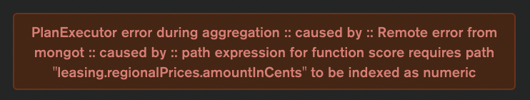

Issue 4: The embedded score modifier on embedded sub-fields
After setting up the index, I can query leasing.regionalPrices using the embeddedDocument query, but when I use the embedded score modifier on a sub-field of the embedded documents:
"embeddedDocument": {
"path": "leasing.regionalPrices",
"operator": {
"range": {
"gte": 31230,
"lte": 31230,
"path": "leasing.regionalPrices.regionId",
"score": {
"embedded": {
"outerScore": {
"boost": {
"path": "leasing.regionalPrices.amountInCents"
I get the following error:
As shown in the JSON index from issue 3, amountInCents should be indexed as numeric, but apparently the pipeline doesn’t agree.
