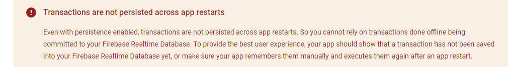

I don’t think I can use firebase to replace Realm. It seems like offline writes are stored in memory so if the app or phone restarts while offline changes are lost.
https://firebase.google.com/docs/database/ios/offline-capabilities
Thanks, @Jay, very helpful!
@Tam_Nguyen1, see this post above:
Yea I saw that but when I was reading the firebase docs there were persist / unlimited cache size options so I thought that meant it was writing to disk and offline writes would be reliably saved … guess not

Firebase is NOT made for local storage. It is an online first database and relying on any data to actually exist at any future point in time locally will not work.
Firebase local persistence is designed to handle brief interruptions in connectivity. For example: if cellular service is interrupted while you’re using the app because the train you are on goes through a tunnel. Or if you have dropout between cell towers. Brief interruptions is what it’s made for.
