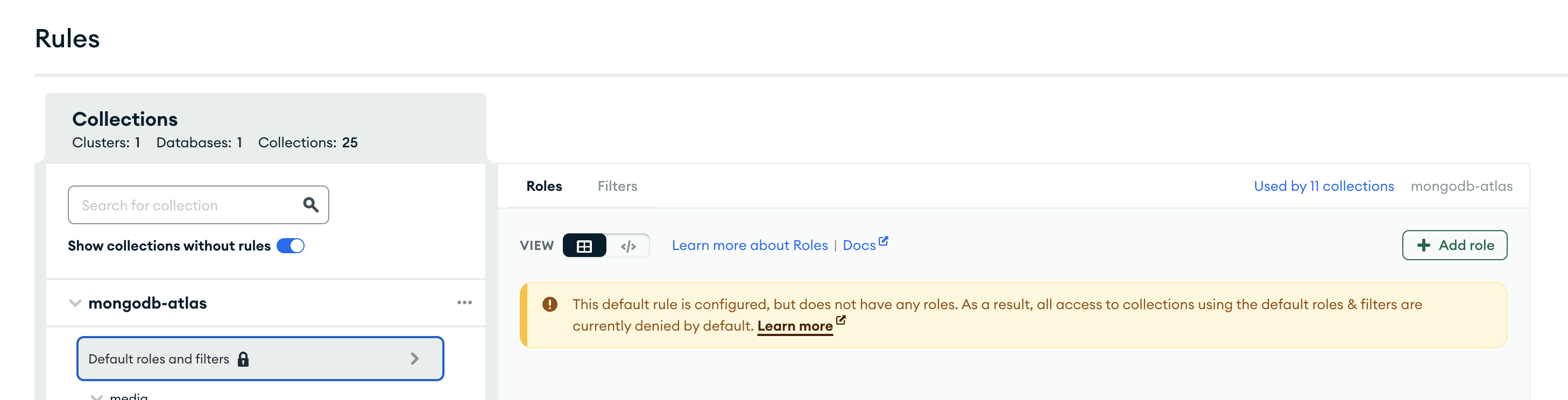

i recently create a react app by using realm web template app, the web-js one, and have this error show up every few second when fetching data. i think it is related with your watch() drops issue.
Uncaught (in promise) WatchError: rule with id="62ec12a7614......" no longer exists on mongodb service, closing watch stream

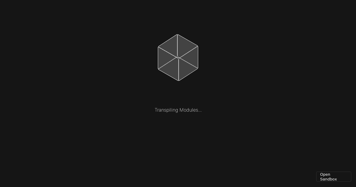

they created this sandbox

I fixed my issue by moving the rules from the default to individual collection, i am not sure why, but the watch error disappeared.

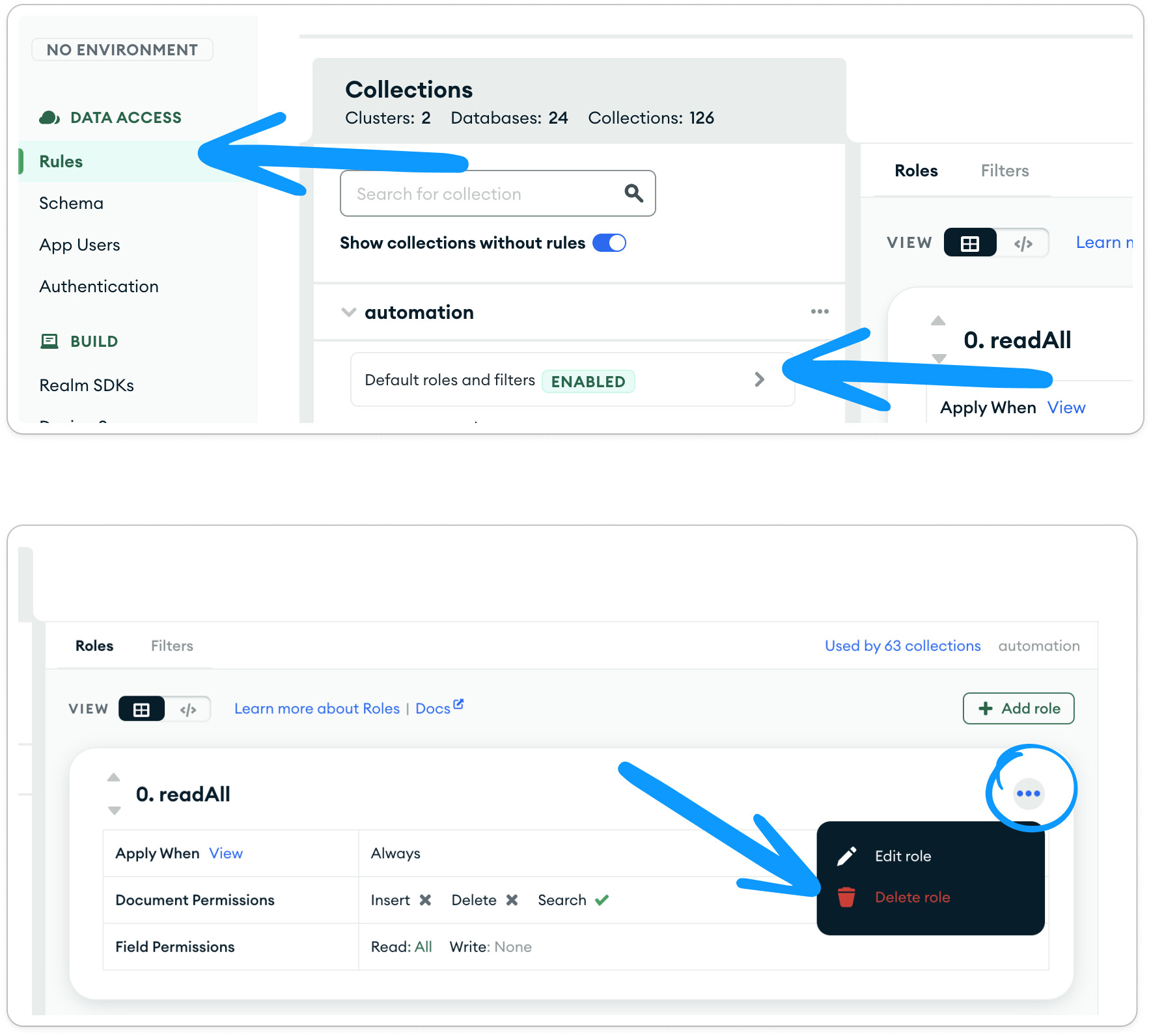

Made a visual guide to help people with a similar issue, Li_Li3 is right- although I wish I saw their comment before doing my own deductions.
Then set granular permissions.

The issue won’t occur, if I use the example app provided here:
https://codesandbox.io/s/9c8bw
However, if I use that very same example app without any changes but using my own atlas app id, the errors show up again.

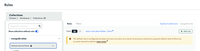

  1. A screen shot of my rules in the App Services UI
Thank you very much for your help, @Paul_Vu.
I finally figured it out. Having DeviceSync enabled, I assumed that those roles would take precedence and while I haven’t tested for that - I still think they do. However, the error occurs when there are no rules (not DeviceSync permissions but “normal rules”) setup. Once I did that and - importantly - no default rules as mentioned above, it did work.
