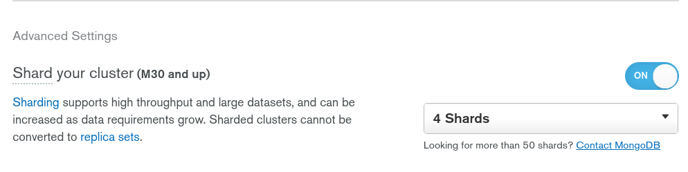

The second and most efficient lever to get real scaling on both reads and writes is Sharding: multiply the number of replica sets to make them work as a team in parallel.

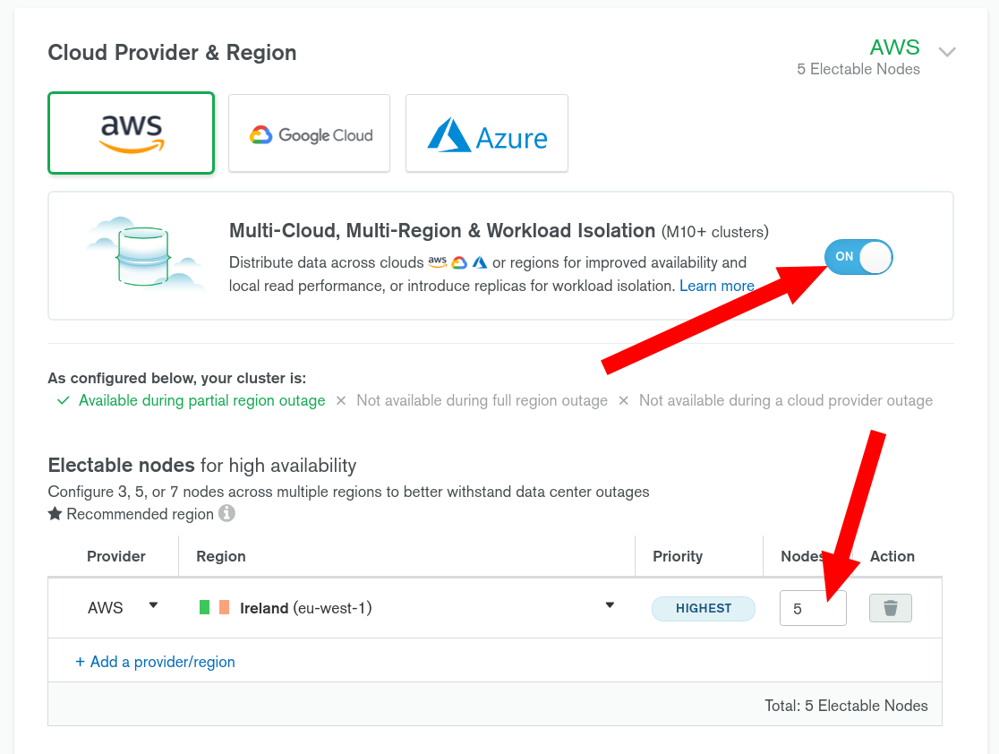

That being said, by default, Atlas deploys 3 node replica sets.
If you want more nodes though, you can activate the Multi-Cloud, Multi-Region & Workload isolation option and increase the number of nodes in the region.
But please, remember that this is not scaling up. It’s just adding more resilience to your cluster.
Sharding (==scaling up) is this way:
