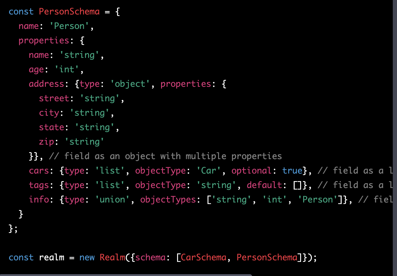

Are you asking about
info: {type: 'union', objectTypes: [ 'string', 'int', 'Person']
If so, isn’t that just a List of more mixed types?
(in the future, please post code as text and use the formatting </> feature, and not screen shots)
