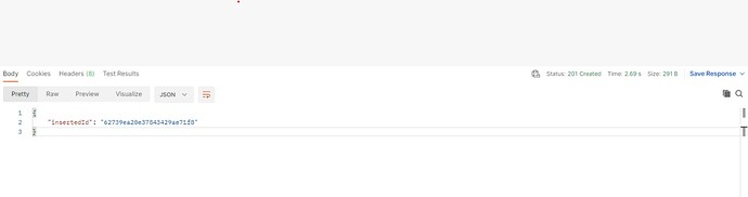

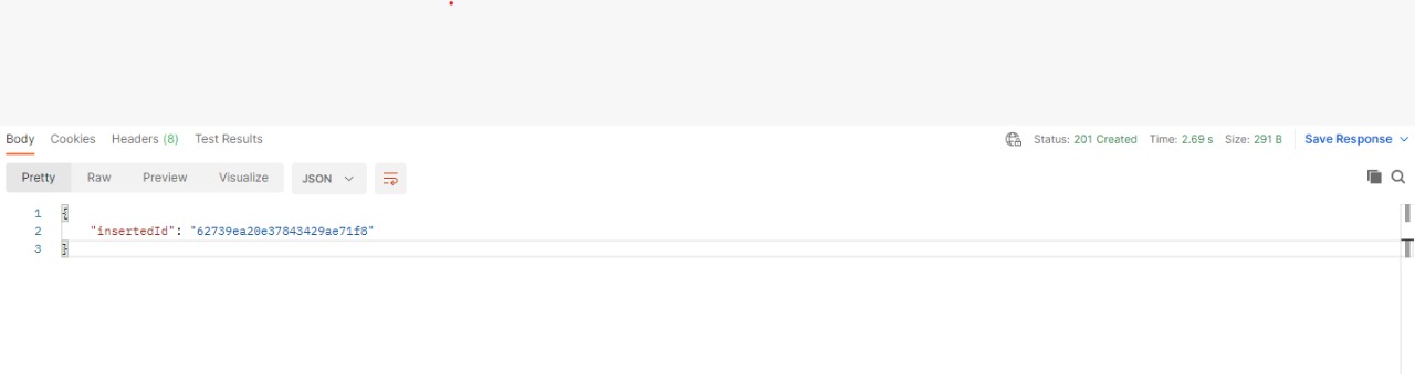

I am trying to call data-api from postman, it’s taking nearly 3 seconds to give response. Is it the normal case? Because querying through connection URL is a lot more faster than this. Will data Api give the same performance as we get from connection URL or it’s slower than the other method.

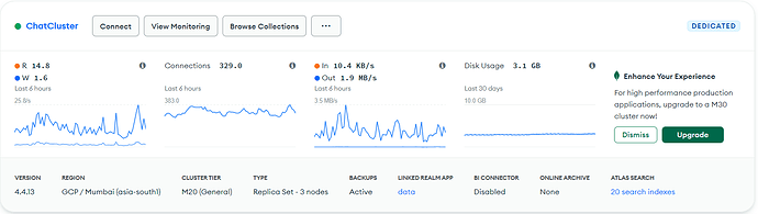

Following are the details of my cluster :

Currently I can see you’ve deployed your cluster on GCP which may cause some latency since the API is default hosted on AWS which may lead to some cross-cloud latency.
