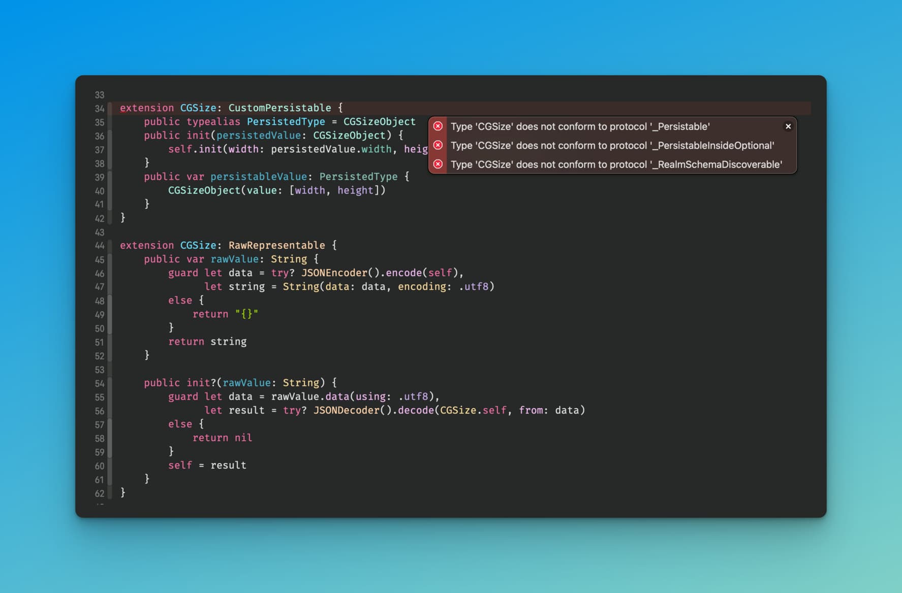

As the documentation mentions I have implemented an extension CGPoint: CustomPersistable to persist CGPoint values. So far so good. Additionally I have to persist CGPoint values in SwiftUI’s @SceneStorage. For this I added another CGPoint extension which implements RawRepresentable.

Unfortunately these two extensions don’t want to coexist. If I implement the RawRepresentable extension I get an error for the CustomPersistable extension.
Any ideas?

By adding the last extension I get the error as shown in the screenshot. CGSizeObject is the type Realm uses to persist CGSize.

Ah, now I see my mistake. It’s the wrong screenshot. It is for CGSize instead CGPoint. However, I made the same extensions for all three types CGPoint, CGSize and CGRect. It’s every time the same error for all three.
