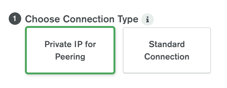

This is also detailed in the FAQ: Connection String Options documentation mentioned above, but the two strings you’ve obtained are from either of the following options when going through the connect modal:
- Which is the right host to connect to, the one with pri or the one without?
Generally, if you’re wanting to connect over the VPC peering connection, you should use the Private IP for Peering connection string. Otherwise, if you’re wanting to connect over the public internet to that specific cluster, you can use the standard connection string.
