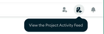

A correction to this section. With developer mode ON, it allows anyone to change the schema from the client side. If other users have permission to access the database they can delete a collection. You can look at the project feed for recent actions performed.
This is accessible from the Data Services tab, top right corner.

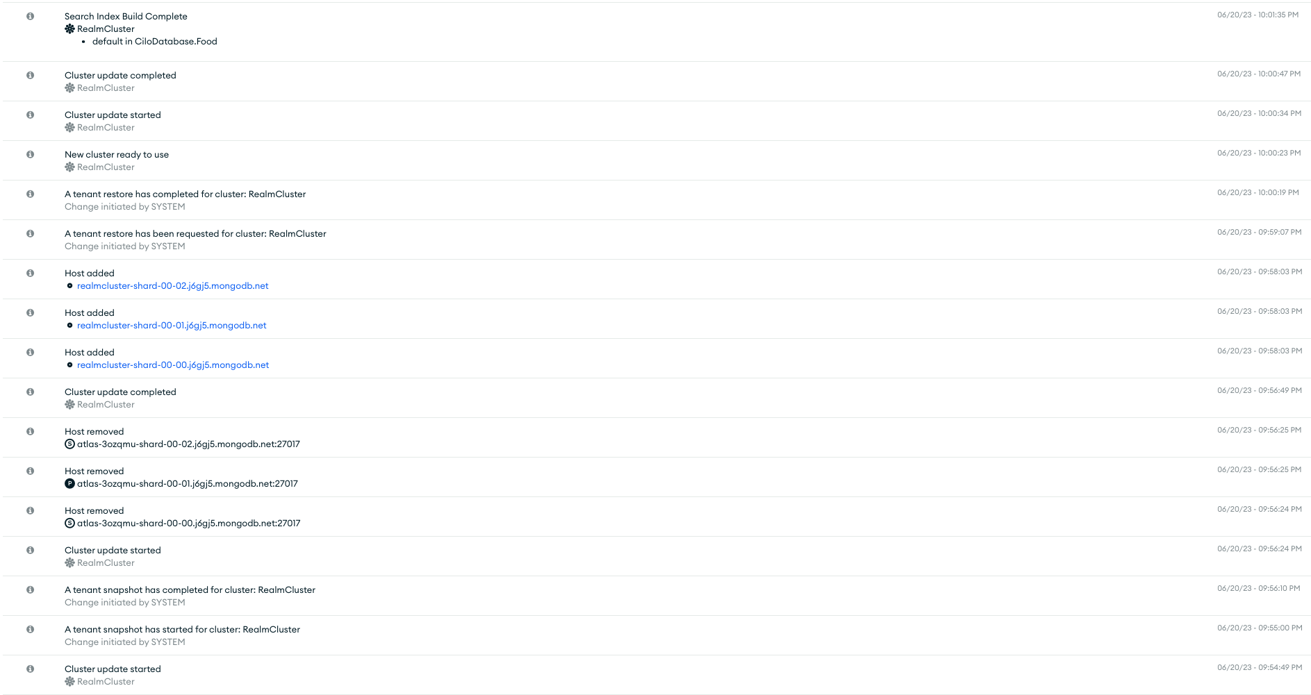

The below image shows the activity feed from when stuff seems to have gone wrong. Can you help me understand what’s going on by any chance?
No action was taken at the time in question by anyone within our organisation that could have caused it as far as I’m aware.
Dev mode is OFF so it sounds like from what you’ve said that nothing could have happened from the client side to cause it.
Could it have been caused by the cluster update? (see the image)
Hi, quick clarification here, no device sync user (regardless of development mode being on) is capable of dropping a collection. This is an action that an Admin takes either through the Data Explorer / Compass or using the Shell / Drivers. A cluster update does not result in dropping collections.
It is possible for us to track down how this was dropped depending on when it happened, but I am quite certain that this must have been a manual action. To that end, if you would like us to keep looking at this could you possibly:
  1. Coordinate with your team and confirm that no one accidentally performed this drop collection
  2. Send us your group_id (see the URL when you are in the atlas console)
In terms of places to go from here, terminating and restarting sync is the only option at the moment. In special cases we can allow you to pass over this, but it would result in an unhealthy state in which Realm and Atlas are no longer synchronized (and we do not recommend that). If client reset logic is enabled, then you should not experience data loss when terminating and re-enabling sync.

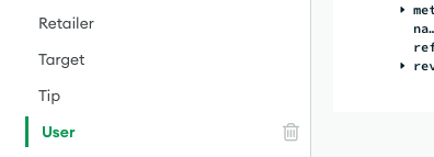

Just so I know (so that I can confirm with my team that this wasn’t done accidentally) if I wanted to drop a collection in Compass how would I do this? Would it be by hitting the delete button next to the collection (see image below).
Screenshot 2023-06-29 at 14.15.10
The collection that it says has been dropped btw is still there in the Compass (it’s the User collection). If it had been dropped wouldn’t it be expected that it would not be there anymore?

Hi, dropping a collection can be done in Compass / Data Explorer with the trash button or the shell/drivers with the dropCollection() method.
Thank you for passing along the link to your cluster. I am forwarding it along to someone on the Atlas team to verify that nothing occurred during the cluster upgrade that might have caused this.
As to why the collection exists still, a number of things could have re-created it. Do you still see all of the users in there that you would expect to see? If so, there is a chance we can allow you to keep syncing, though it would be very odd and surprising to me if so.
