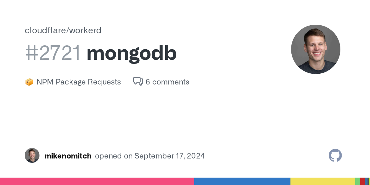

We can’t force Cloudflare to do anything, but based on mongodb · cloudflare/workerd · Discussion #2721 · GitHub it sounds like there might be some movement on this in January.
More information will be shared as it becomes available, but I’d recommend following that discussion thread as well for the time being.
