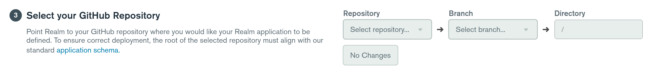

You can choose the branch to sync from in the step 3:

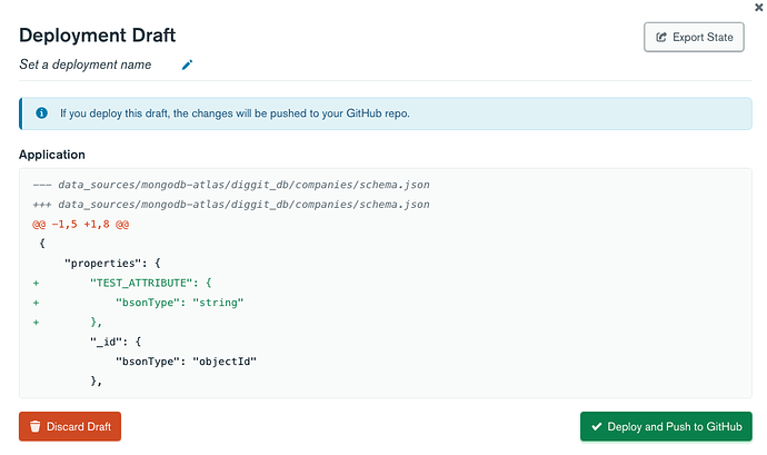

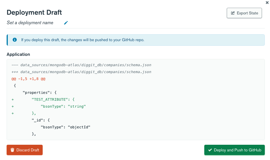

Here is an example when I configure my realm app to have automatic deployement to/from my master branch on GitHub.
  1. I make changes to the schema using the UI
  2. I deploy the draft changes and get the following message:
  3. I press ‘Deploy and Push to GitHub’.
  4. Under the deployment history tab, I then see the following:
  5. In my GitHub repo, I see the changes that have been pushed from Mongodb-realm itself
So if I understand correctly, the deployments can take place in both directions (at least for the master branch). Why does this not work for the dev branch then?
