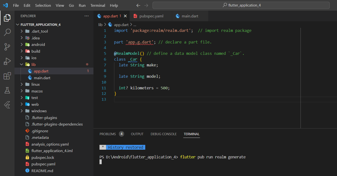

Screenshot_103
Adding your model to a freshly created flutter project in the file lib/app.dart and running generate

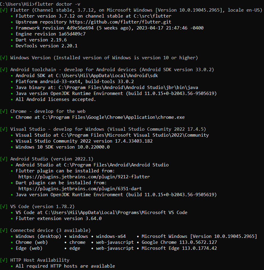

Also, what is the output of flutter doctor -v?

When I run the command there is no output and it just hangs, even though I have created a brand new project
