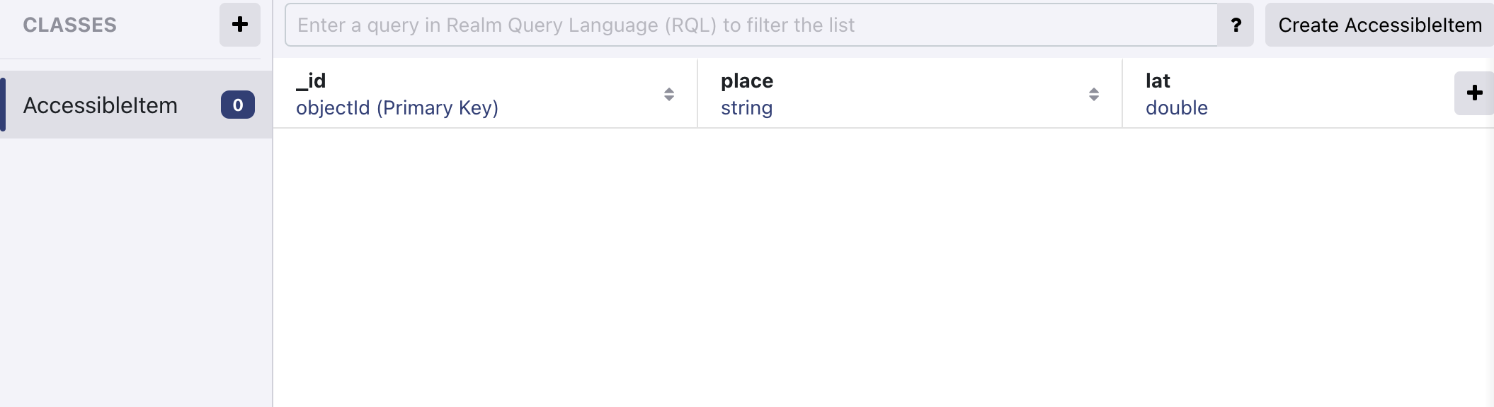

I am using device flexible sync on App UI as per Swift examples. The correct roles, permissions and filters are in place. I use anonymous credentials to login and to add a flexible sync configuration. I’ve added a subscription. The logs on the App UI show a connection starting, a session starting, and the status is okay. But there is nothing on my local realm sync default file. What am I missing?

Local realm file
Thanks.
Hi, is there any data that should be added to the file? IE, are you writing any objects to the Realm or is there any data in Atlas that should be getting synced? If so, can you explain where the data is and perhaps add a link to your application in the App Services UI? Separately, can you clarify what your document filters are set to? You seem to suggest it is both { read: true, write: false } as well as { place: { $exists: true } , address: {$exists: true } }

I want to sync the data on Atlas with the local Realm file. Currently the user cannot write to the file. This could change in the future. The collection is on a shared cluster tier, the atlas service name is mongodb-atlas.

I’ve set the rule to everyone can read. I deleted the sync default realm file and also changed
    let realm = try await Realm(configuration: config, downloadBeforeOpen: .once)
to
    let realm = try await Realm(configuration: config, downloadBeforeOpen: .always)
before starting up again.
It is now working.
