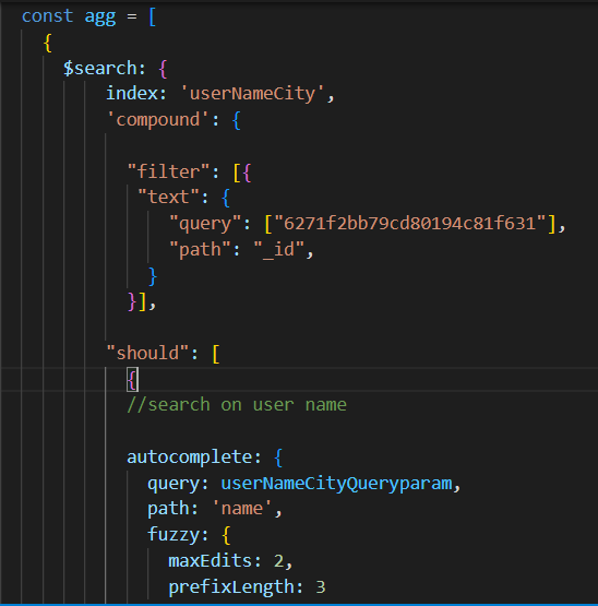

I have the same issue however the search is not giving result.
Question: Do I have to create index for the filter field i.e. userid?
“mappings”: {
“dynamic”: false,
“fields”: {
“_id”: {
“type”: “string”
“city”: {
“type”: “autocomplete”
“contactfirstname”: {
“contactlastname”: {
“name”: {
