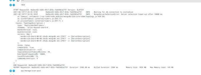

and here are the errors that I keep getting, about 1/3 of the requests fail.
error2
