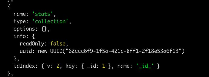

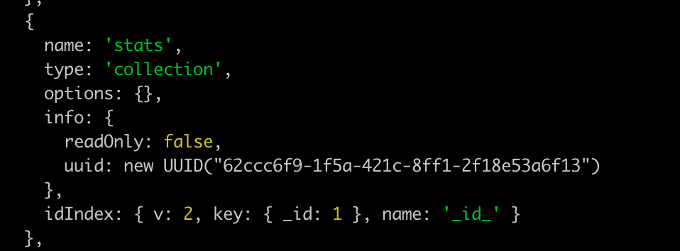

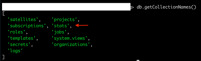

Both created a collection, which I verified via the Compass UI, the Atlas UI and the mongosh shell. It’s visible when running the command db.getCollectionNames and getCollectionInfos and it’s visible in both Compass and Atlas.
Collection info from mongosh terminal
Running db.stats.findOne() outputs this:

You chose a collection name, stats, that collide with a function of the db object. This means you will not be able to use the short cut db.stats to get the collection. You will need to use the getCollection() function like:
db.getCollection( "stats" ).findOne()
That was it!!! The above command works perfectly, and I’ll be more careful when naming next time.
