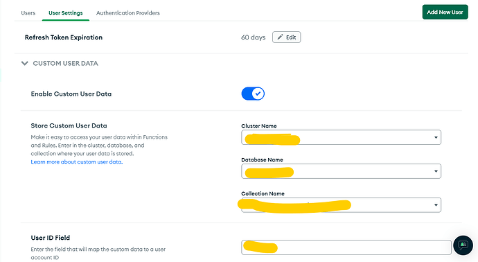

your resources were of great help, I have successfully been able to implement the basic react native features to get my device sync working,(I know this cause i can see my sync events in the Device sync section) however I have not tested it and I wanted to try it out first by the login process and specifically using data from my collection, I tried using custom user data and imported the collection containing the data but i see zero user list, Also as it is on my application it is convenient for my users to login with phone number and password instead of email.
how do I go about this
thanks

Do you have any Idea why I cannot see my users from the imported collection, or what can lead to them not being seen
I am not entirely sure what you are asking about. Can you add some more detail about what you are doing, what you are seeing, and what you would expect to be seeing?

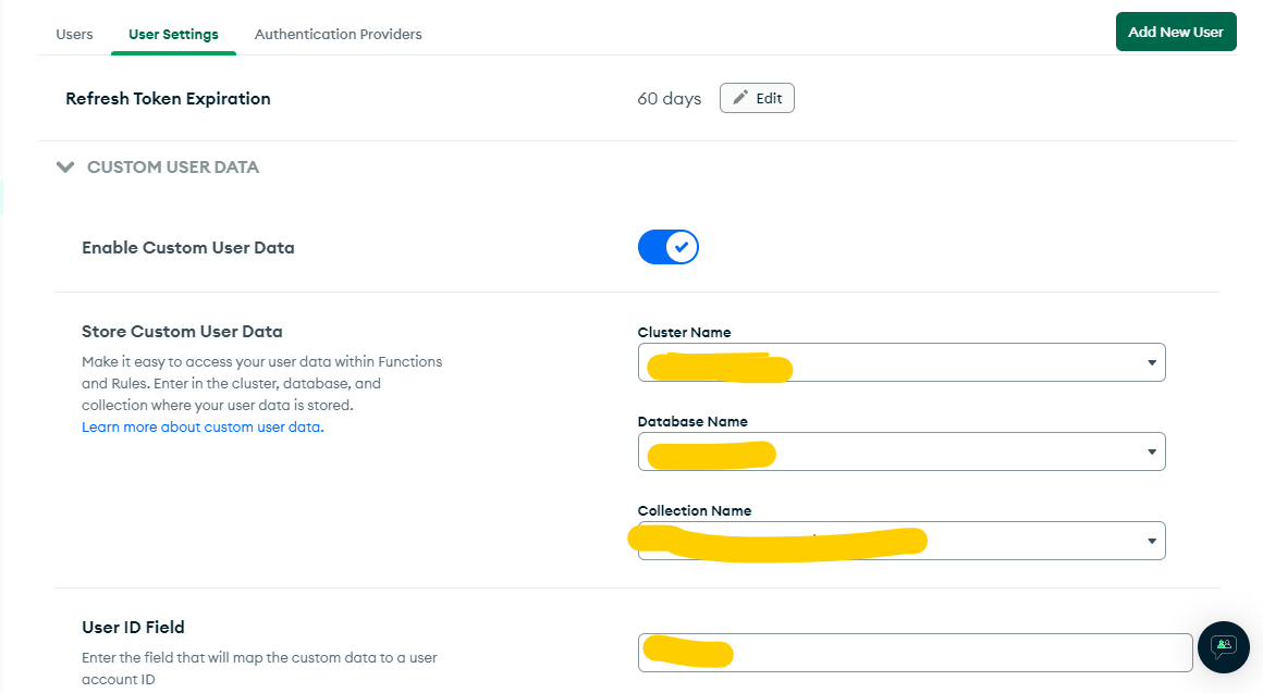

I selected the custom user data and I have passed the collection that has my user data…i would like to use that data to handle the logins…Is it not supposed to show that list under the “Users” section or how exactly does it work?
Hi, I think the issue here might just be a slight misunderstanding in what custom user data is. I would recommend reading through this docs page: https://www.mongodb.com/docs/atlas/app-services/users/custom-metadata/
The TLDR is that we allow you to use “rules” to set permissions on who has access to what data. If you want additional information about a user to be present at the time of rules evaluation (you have roles, access lists, etc) you can use custom user data, and when a user logs in we will get that user with that user_id field (if it exists) and you can have a rule that references it in some way.
Therefore, the issue seems to be that you think this is seeding the user’s list, but really this is just metadata that is used as a lookup during permissions evaluation.
