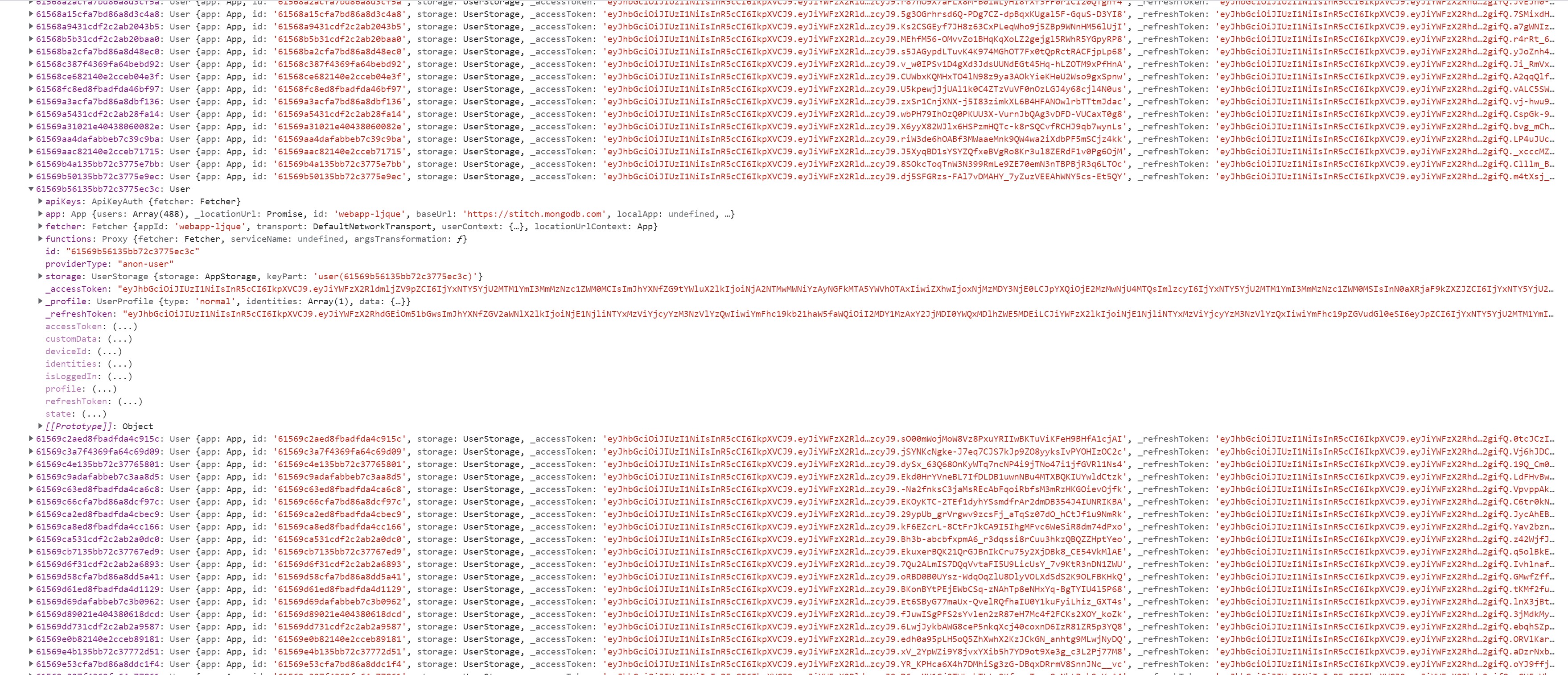

@MaBeuLux88 @Andrew_Morgan I’m currently using Realm GraphQL with an SPA and I’m experiencing the same issue for anonymous users as @Patrick_Mamba stated on Open API - anonymous user registered for each request :
I’ve tested with logged in user account and api keys and the issue doesn’t happen in those instances. It’s only anon-user that has the issue. Any idea on what can be the cause of this? While I’m dev/testing I have hundreds of anonymous users in the app.allUsers array:
