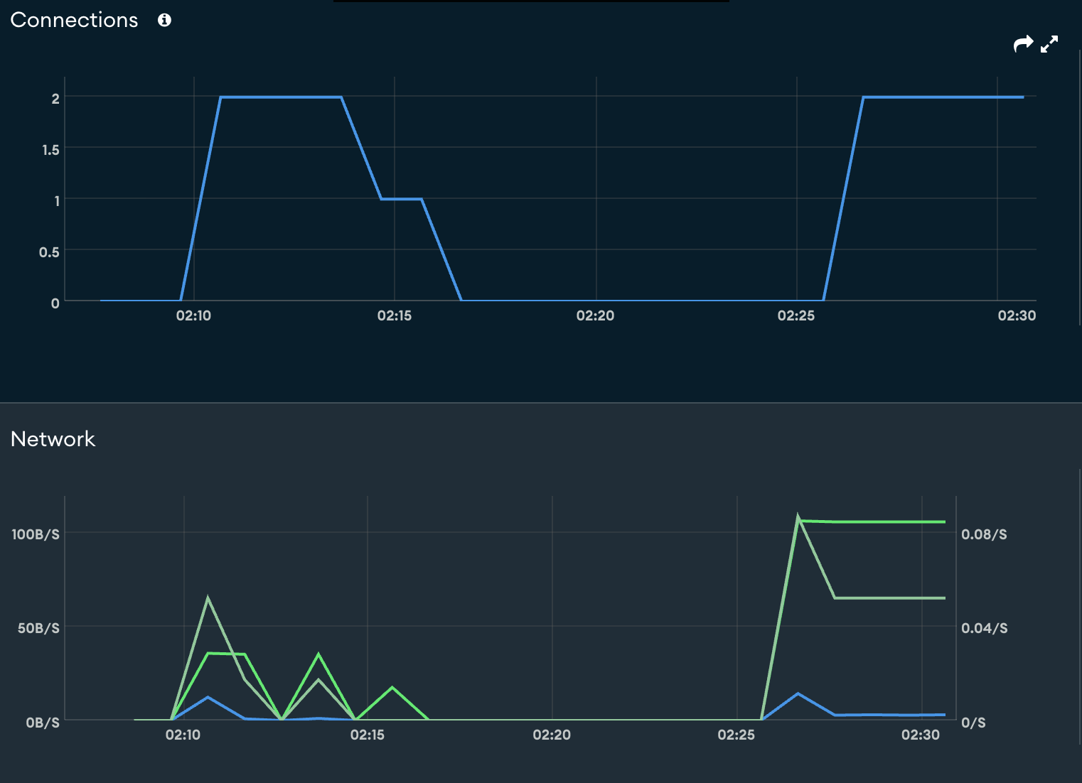

I’m going to use the heartbeatFrequencyMS option in the pymongo driver as an example on my test M0 cluster to help demonstrate.
In the following screenshots, you will see a single client connect at 2 different points for several minutes each time. The first block where the connections spike will be when the heartbeatFrequencyMS value is set to 100000 - Note the Network metrics during this time. After close()-ing the connection and waiting several minutes, another connection is made again but with a heartbeatFrequencyMS value set to 20000 (20% of the first connection) in which you can see higher network usage:

It’s important to note that I am not advising you to change the heartbeatFrequencyMS option here. This is only to demonstrate that even though my connection is not performing any read or write operations, the connection(s) still requires network usage.
